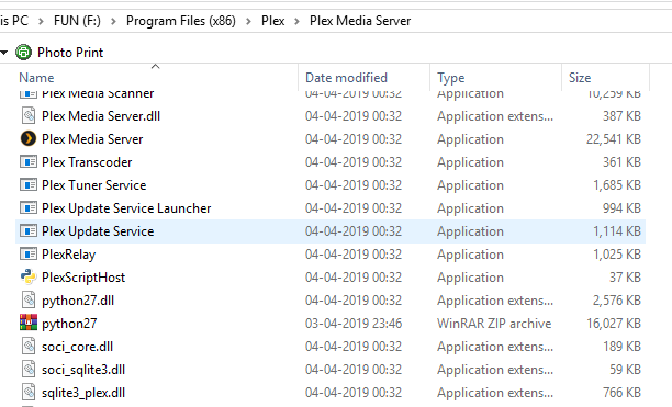

Both my server and client in F drive SSD and OS drive is Nvme m.2 faster than thes
