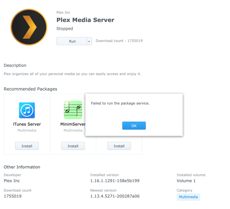

I’m contacting you because it’s been 4 days now that i’m not able to play my videos by PMS.
Nothing on my TV, I checked from a browser and the classic message “Your server isn’t available” (Serveur indisponible).
On my NAS (Synology) I checked in the Package Center to check the PMS package and it’s not running.
And the issue is the next : every time i tried to click on “RUN”, i have the same message “Failed to run the package service”.
I tried to uninstall PMS from my NAS and install again but even if the installation run correctly I have the same “failed to run the package service” at the end.
I cheked all autorisations to be sure and it seems to be fine with me.
Please, can someone help me ? Thanks a lot.

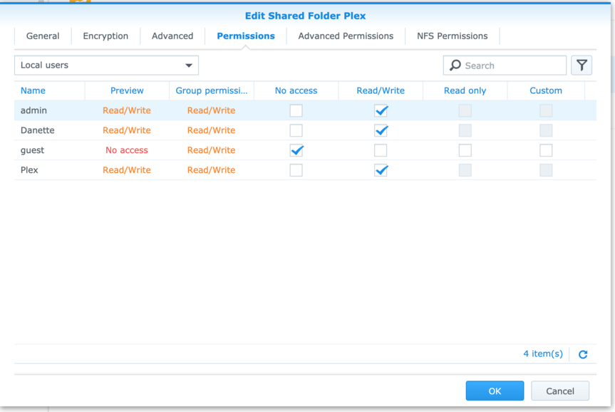

Please check:
  1. Control Panel - Shared Folders - EDIT the Plex share - Permissions - User Plex has R/W to the Plex share
  2. If yes, Add your username to that list (if not already present)

Hi @ChuckPa, thanks for your response.
For the permissions, User Plex has R/W and mine too.
