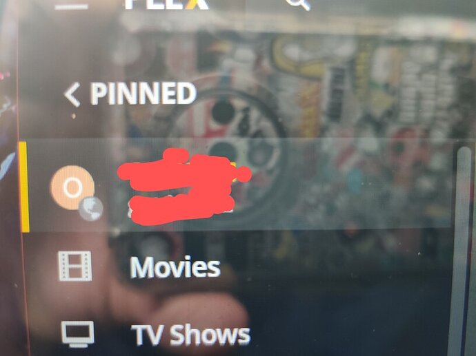

Anyone on my server can connect and play media without any problem except for my brother. And for my brother, anyone can connect and play media on his server without a hitch, except for me. When I look my brothers server on my laptop, I see a Earth symbol over his username. It’s grayed out. If I remember correctly it should be green.

If you notice, there is a gray symbol that resembles Earth on the username icon. If I recall correctly it should be green.
The little Globe icon just means a server isn’t on the LAN.
I don’t think the Globe icon changes color, or indicates whether a connection is Direct or Indirect/Relay.
