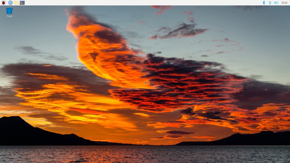

I am going to assume you have a working compatible Raspberry Pi with Raspberry Pi OS 64Bit installed and you are staring at a screen that looks something like the image below for Debian Bookworm:
Or something like this for Debian Bullseye

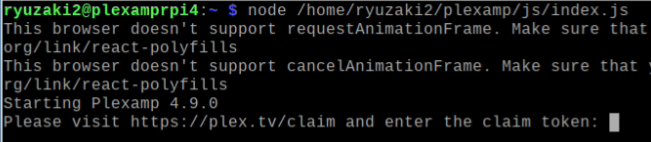

Plexamp should be installed now but it is not signed in, not running and it hasn’t been claimed yet. So Now you need to get Plexamp running as a service and claimed. We can get it running by typing in the following line of code:
node /home/USERNAME/plexamp/js/index.js
Note: USERNAME is your username.
You may or may not see some errors here. If you see the words “Starting Plexamp 4.x.x” and then some weird errors its ok to ignore the errors. Plexamp is running. If you see something that says cannot find module then you may have copied and pasted wrong, or typed something by mistake or forgot to replace USERNAME with your username.
Claim the Token
In the terminal you should see something like this;
Open the web browser Screen Shot 2022-08-28 at 11.00.20 PM on the Raspberry Pi and go to the website, it will prompt you to sign in. Sign In, and then copy and paste the claim code it gives you into the terminal and hit enter. It will ask you to give the player a name. There should be some more random errors you can ignore these and then it should end with a message that Plexamp is now signed in and ready!.
