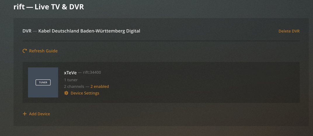

Works as a charm. I can now navigate to Settings-> Live TV & DVR and add TellyTV:
Seems to work. But when I now try to play a show on one of the enabled channels (e.g. using Chrome browser as Plex client) I get a Playback Error:
every time. Why is that?

And added xteve as a LiveTV source to plex:
But I keep getting the Playback error:
Damn!
What’s wrong here?

Just had a quick look. At the first glance it looks very similar to mine. I activated FFmpeg in xteve. Not sure if that makes the difference?
And if course restarting the Plex container before changing the tuner setup.
Hope that helps.
