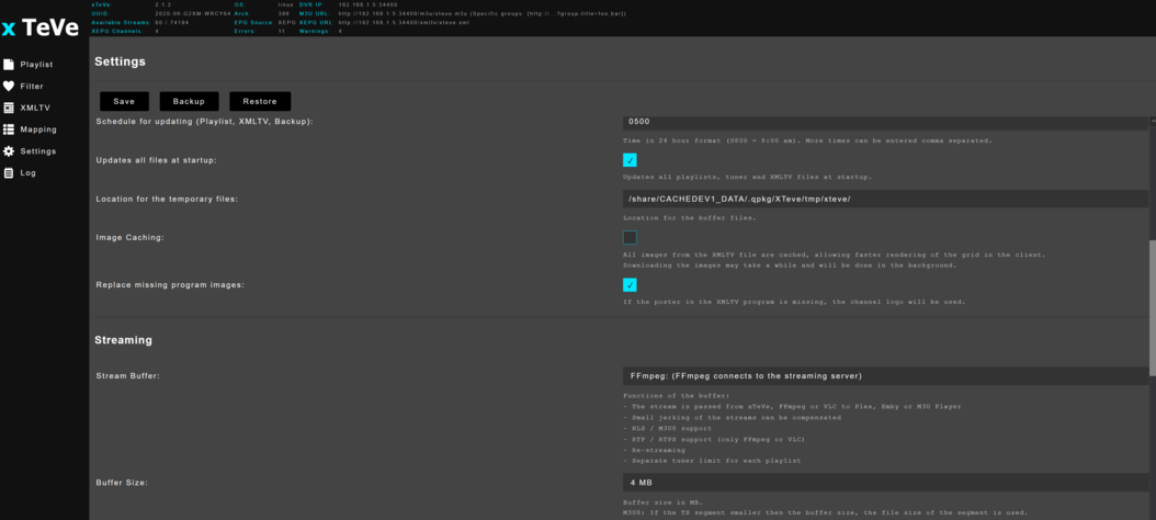

try this, it worked for me.
go to Xteve gui → Settings → scroll to streaming section and for Stream Buffer change it to Xteve or ffmpeg.

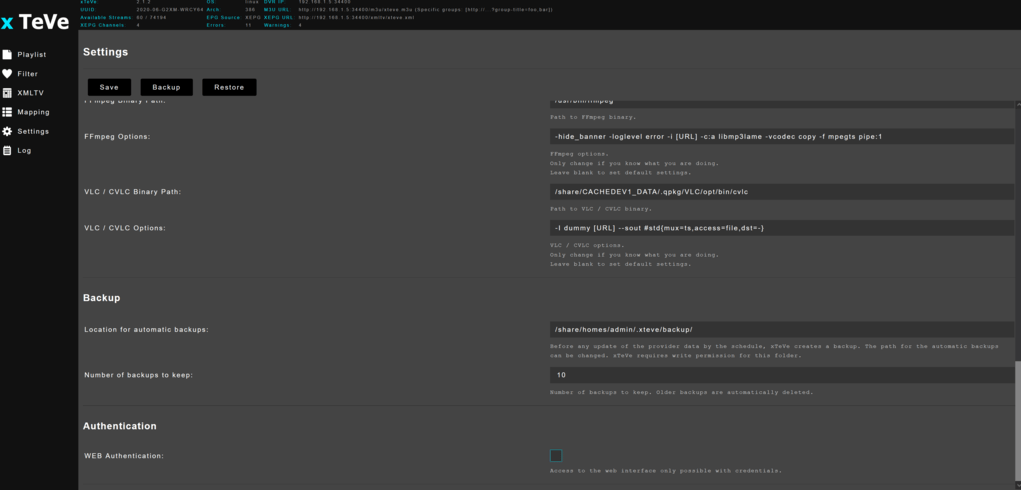

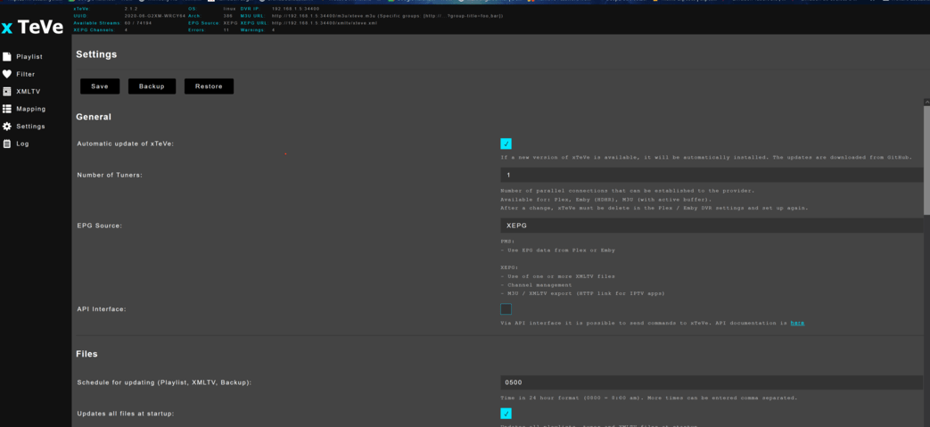

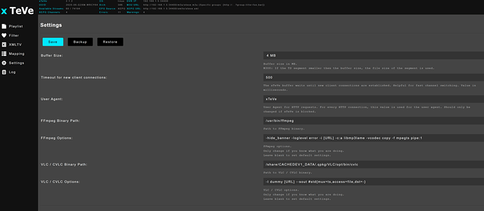

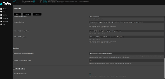

Here a photo of my settings in xTeVe:
Now my problem:
Neither with the link: http://192.168.1.5:34400/m3u/xteve.m3u nor in Plex nor with the links from http://192.168.1.5:34400/lineup.json do I get the streams to run.
I have mapped only 4 channels for the test.
What am I doing wrong ?
Thanks for your help.
Greetings
Chris
If you’re insistent on using FFmpeg then the CLI option should be -hide_banner -loglevel error -i [URL] -c copy -f mpegts pipe:1 as per the default.
I would completely turn FFmpeg off and set Stream Buffer to No Buffer. It’s rarely needed unless you’re trying to transcode the stream with very specific options.
Plex already uses FFmpeg in the server so why exactly would this make sense to go FFmpeg(xTeVe) → FFmpeg(Plex) → Client app. It just doesn’t under most circumstances.
