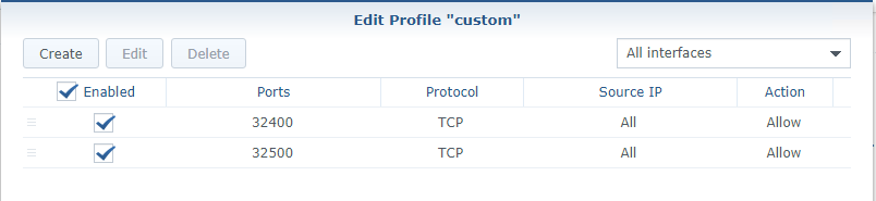

Oh, I understand that, yes. My problem seems to be the router port forwarding rule. I can’t specify AnyIP:32500->NAS:32400. Apparently all I can do is AnyIP:32500->NAS:32500 (i.e., I can’t specify the internal port to route the incoming traffic, just the external port to open)
The Synology firewall is set for 2 rules, TCP 32400 and TCP 32500 ALLOW.
Even tried turning off the Synology firewall completely. Still no joy

Attached screenshots of Router port-forwarding, Synology firewall, and Plex NAS.
