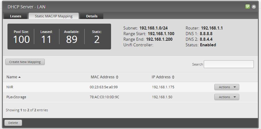

Ensured the DHCP reservation was correct. .50 is outside my DHCP range of 100-200 (pic below)

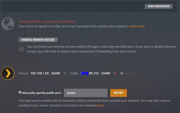

Hit retry on the remote access screen and still have the same error:

The logs are just showing that the attempts to connect from the plex.tv servers to your public WAN IP 71.73.xxx.xxx on public port 32400 are simply not getting through. Each attempt to connect to this IP and port is resulting in a logged event to say it was not possible to get through - eg
Dec 04, 2018 21:45:35.092 [0x7f29f97fe700] DEBUG - EventSource: Got event [data] '<Message address="71.73.xxx.xxx" port="32400" asyncIdentifier="d9778e82-4bfc-4504-8898-d2a518e1f304" connectivity="0" command="notifyConnectivity"/>'

This is actually incompatible with your router setup shown here Cannot enable remote access - #15 by mataraza
Your DHCP Range in the router was shown to be 192.168.1.100 to 192.168.1.200 and so a DHCP reservation for 192.168.1.50 would not make sense. You could change the range to 192.168.1.50 to 192.168.1.200
I am not sure if it would cause any issues but it is wrong. It may lead to an error getting returned when the DHCP renewal is attempted. I would not know what the OS would do when it gets the error
If you want it to be outside DHCP Range then on the server side it would need to be static and not DHCP and of course then you would need to define your netmask and dns servers etc

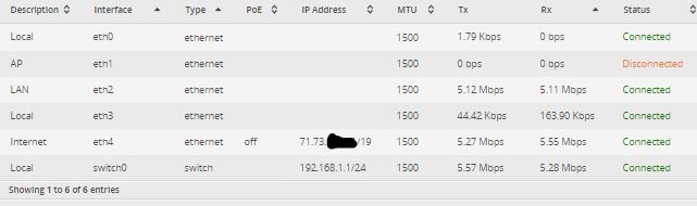

Here is the screenshot of my router with the external IP
router
I am not sure if the dhcp issue has any impact - it was just an observation of incorrect configuration
Any reason as to why the local network on the router page is showing as switch0 and switch rather than eth0 and ethernet
