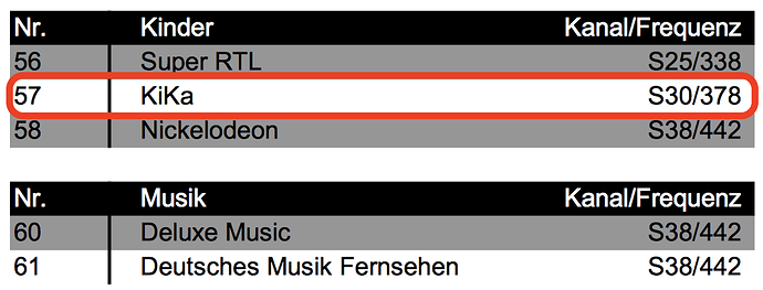

I scan manually and found all the channels, and sort the EPG to the Channels, that I found. But some Channels has no EPG, if I take a look at the Channellist of my Cableprovider, I can see that all the Channel thats above S25 are have no EPG Information hat, that I can sort to the Channel:
Channels of my Provider above S25:
But no EPG to Channels above S25:
My Question, is it possible to edit the Settings (maximum Channel for EPG to to e.g. S38) or is there an other Way to add the EPG?
The Problem is, that Channel is the most important Channel - KIKA HD (Kinder Kanal, means Children Channel!)
