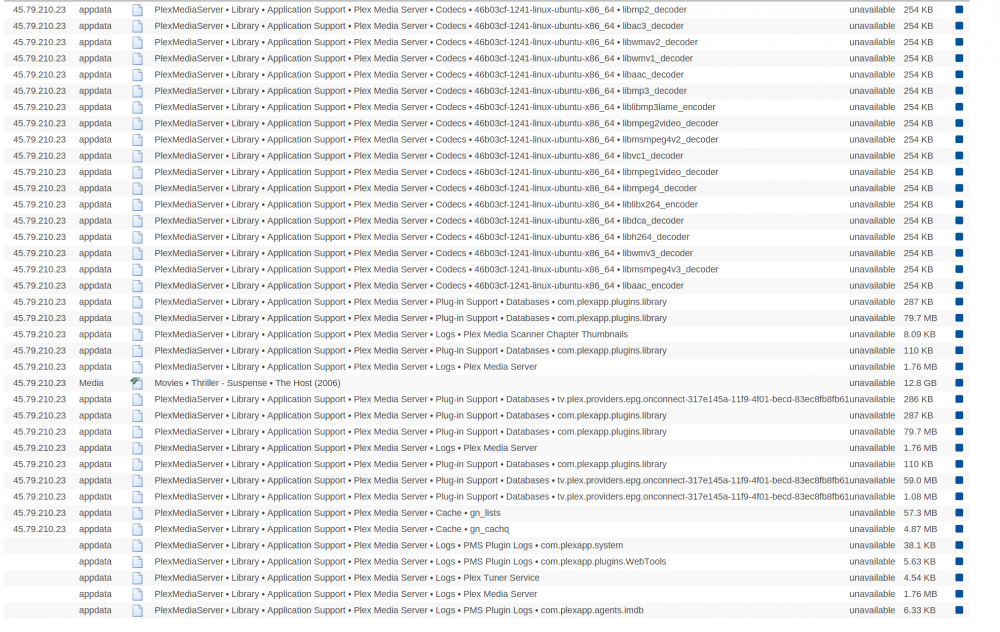

I run Plex on my unRAID server. Last night I noticed one of the drives containing media on my server had a very high number of reads and was “spun up” when nothing should have been accessing it. Plex showed no activity under the status monitor, so I looked at a utility plugin on unRAID called “Active Streams” that monitors what is being streamed off the server. It showed a large number of active streams going to a client outside my network. All of streams appear to be “library / database files” that are part of plex, plus one single actual movie file running and it was located on the spun up drive with all the reads. I could not spin down the single drive, until I (via unRAID) halted the stream, and then the drive would spin down. If I “halted” everything, the connection to Plex files always immediately restarted, and after about 10 or 15 minutes the movie stream re-started.
Attached is a screenshot of the “active streams” showing what was running on unRAID with the Plex references.
So here are some interesting points:
  • A websearch of the client ID for the stream (left hand column) is an IP owned by a company called Lincode, who is a cloud hosting provider out of NJ and the IP is in Atlanta.
  • When you stop the streams and they re-start, the client IP changes 3-5 times in front of your eyes. I’ve checked at least two of the IP’s that appear and they were both connected to Amazon / Amazon web services in Ireland.
  • When I log into Plex, no streaming actually shows up in the app, even when the movie was being streamed, so this is behind a back door somewhere.
  • When I turned off “make Plex available outside my network” the above streaming continued.
  • When I turned off plex all together, the above streaming stopped.
So at the moment unless someone can tell me this is somehow normal Plex behavior I don’t even want to run Plex in my house because turning off the firewall accessibility didnt solve the problem.
I haven’t tried changing the port for outside the network access, but given the above statement would that even work? I did not manually set up any port forwarding in my router. It was all done by Plex.
This seems like some media sharing service (like kodi) is scanning my collection and playing videos. I dont use kodi or anything like it. As I type this I recall that there is a kodi app installed on my Shield and possible on a Smart TV. I’ve never set them up or used Kodi, but in the off chance they have somehow connected I will uninstall them (if i can) tonight. If that was the issue I’d be disappointed to find out it was able to do this behind the scenes.
The rotating IP’s at the start sounds like someone who is spoofing their IP and that is also very concerning.
Has anyone seen this behavior before? Any suggestions about what to do?

OK so “Perform extensive media analysis during maintenance” is checked. What is that doing exactly and is it important?
Is that what you were talking about?

So on schedule the scheduled tasks started and the same exact media file shows up in active streams. I turned off both " Perform extensive media analysis during maintenance" and “Upgrade media analysis during maintenance” but nothing changed and the media file still shows up under the active streams section.
If nothing is active from PMS, you have something else going on. Whatever that file is (look at now playing), you’ll find out what it is. get the IP and trace it (geo lookup)
If it’s not in your home or one of those you share with, you have a bigger security problem .

Sorry it’s been a little while and now I"m resurrecting this thread. There are two concerns I have with all of this.
  1. The way I found this issue was the video file shows up on my server as as an “active stream” to the LiNode / Plex servers. It connects the stream to the IP 45.79.210.23. See attached screenshot and you will see what I’m talking about Look for the file "The Host (2006).
  2. The exact same files “streams” every single night. no other files, just this one. the individual drive currently has 29 million reads on it.
Does this sound like the function you were talking about?
