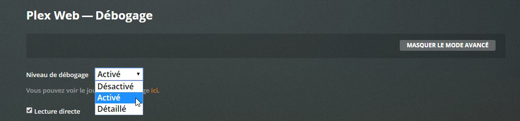

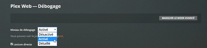

Yes, it’s saved. The option is on this.
Disable / Enable / Detailed
