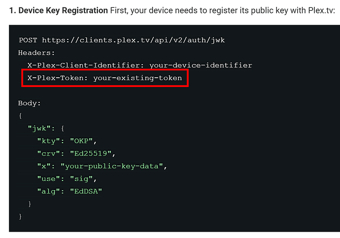

The first step in the JWT Authentication is the device key registration which requires the header X-Plex-Token: your-existing-token.
How do I get the existing token in the first place? Do I still need to use the Traditional Token Authentication (Legacy) method initially to get an account token before I can use JWT Authentication? In which case it’s not really the “legacy” method.

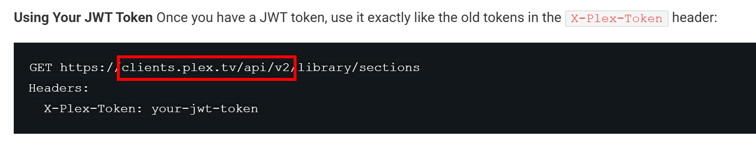

Side note: I believe there is a typo in the last step of the JWT Authentication. The URL should be pointing to a Plex Media Server instead of to clients.plex.tv.

I hope, but I don’t think this is a Typo. The first step mentions that you need to “register the device with plex.tv”. Wouldn’t that mean that you are registering something on your Plex account rather than that specific Plex server?
The last step is using the JWT. You use the JWT to query your Plex server (that’s what the entire documentation page is about). /library/sections is a Plex Media Server endpoint to retrieve a list of the server’s libraries. It is an invalid clients.plex.tv endpoint.
Ah, I see where I made the mistake. Yes, the library/sections doesn’t really make sense to run against an endpoint on clients.plex.tv.
I’m glad to see I wasn’t only one banging their head to a desk with that token thing.
The documentation says:
X-Plex-Token | An authentication token, obtained from plex.tv | XXXXXXXXXXXX
but nothing about how or where to even obtain it. You have to look it up like this: https://support.plex.tv/articles/204059436-finding-an-authentication-token-x-plex-token/
I still haven’t gotten my JWT authentication to work though, but figured I would at least share that bit of info if it helps anyone
The authentication token is/was the normal way to access your Plex server. However, in the API documentation, it is stated as “legacy”. So, using that “legacy” token as a way to issue a JWT token doesn’t really make much sense.
For now, this would work until that “legacy” token wouldn’t exist anymore and probably everything has been moved to JWT/JWK. But then the question still remains: how do you issue a new JWT from scratch?
Could be they are keeping that old token from the legacy only while deprecating legacy authentication itself as an option in favor of JWT. But would need someone from Plex to actually confirm that.

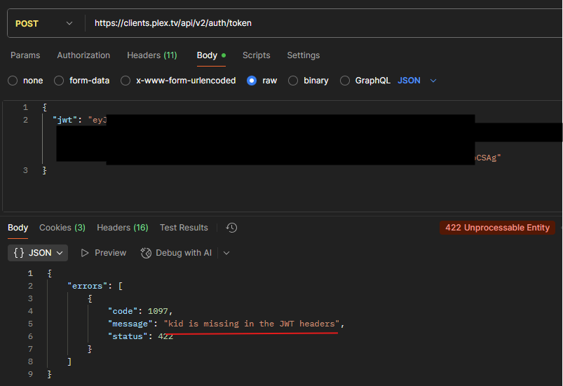

then built a JWT with the attributes mentioned in the docs but when I call the token endpoint I get that the “kid” attribute is missing
Now the docs don’t mention it
I did try to put something random in there and still got the same response. Am I missing something? Also, totally agree - it seems strange to have to still obtain a ”legacy” Plex token to start this process.

  1. The token before the key problem:
    1. Clients are added to an account in the same way as before and through that they are given a token (the legacy method)
    2. When a client registers a JWK with plex.tv, the aforementioned token is removed from that device and all future auth is performed via the JWTs obtained by using the JWK
    3. I presume there will eventually be a mechanism for a client to register with a JWK directly but it was not yet part of this system last I saw it.

  7. /library/sections is a Plex Media Server endpoint to retrieve a list of the server’s libraries. It is an invalid clients.plex.tv endpoint.
    1. Yeah, this is new to me and was not in the documentation as last I saw it. I’m guessing a mistake from a rush job adding all of this to the PMS docs.

You need to do for now at least, both the legacy way and JWT way. JWT needs an auth token from the legacy method and JWT should be more secure than legacy.
Hey @gbooker02! Thanks for these details. This is all correct! :plexheart:
I’ll add the details of how to get a JWT without ever having to get a legacy token. This is new and will be included in the PMS docs in the next update, along with the feedback from here.
You can use the strong Pin authentication flow and include the JWK of your device. For this flow, a nonce is not required in the signed JWT you will share in the end:
