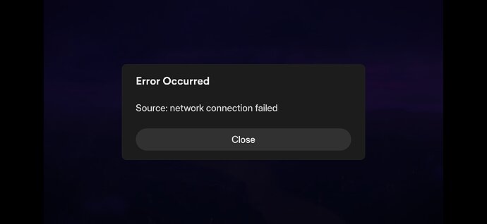

This was to android app, the error I get shown on the app is this.

I checked a little bit further and noticed that for the movie I had trouble with, 2 versions of the movie were available in plex: one UHD, one for streaming around 10Mbps.
(Plex always chooses this version even on LAN but that’s another story).
The issue is only happening with this optimized version so it might be a problem with the way the source file is encoded. I don’t have any artefact using the older transcoder thought. If you want to investigate, I have a log zip ready to be sent privately.

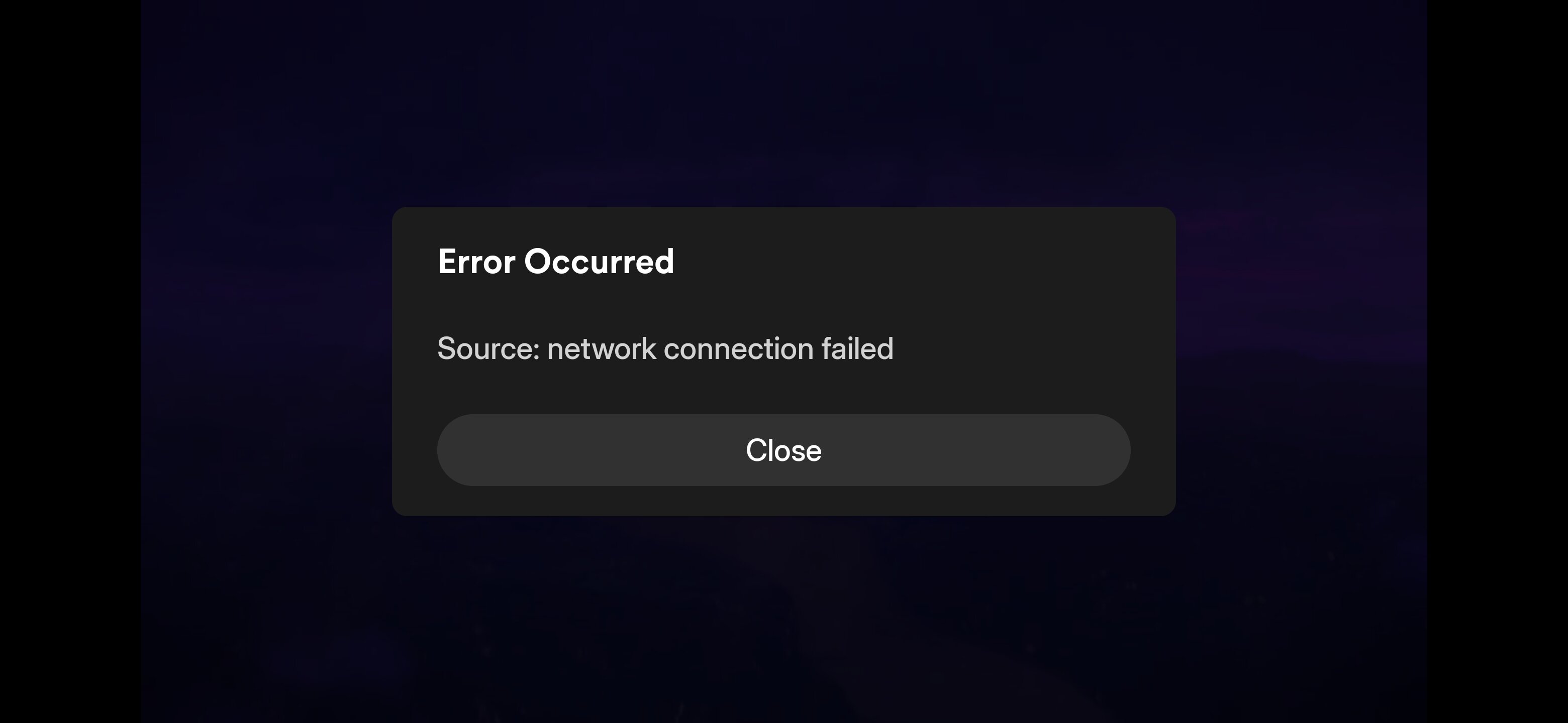

And 4 screenshots :
  1. After the first try of Live TV
  2. After the second try with the “4294967279 error code
  3. After thatn Plex thinks that I watch Live TV but in fact PMS is crashed
  4. If I launch Plex client on my PC after that, my PMS server is unreachable, I need to restart PMS
