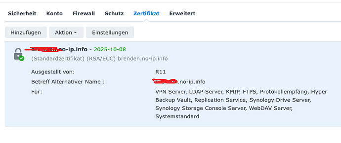

I get this when I export the certificate from my Synology.
Would this work?
