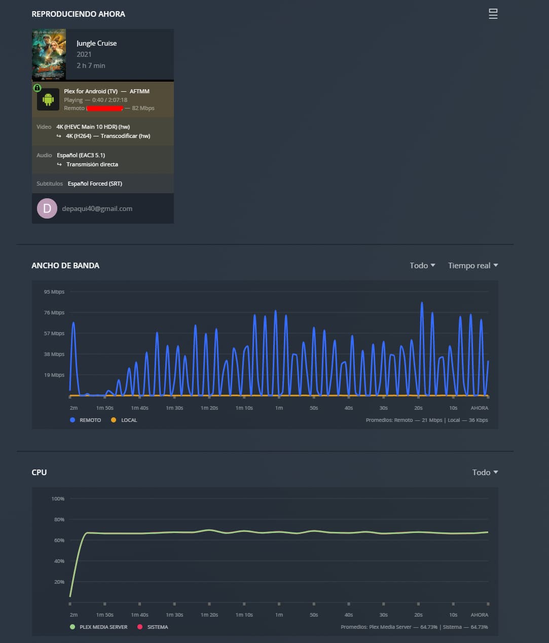

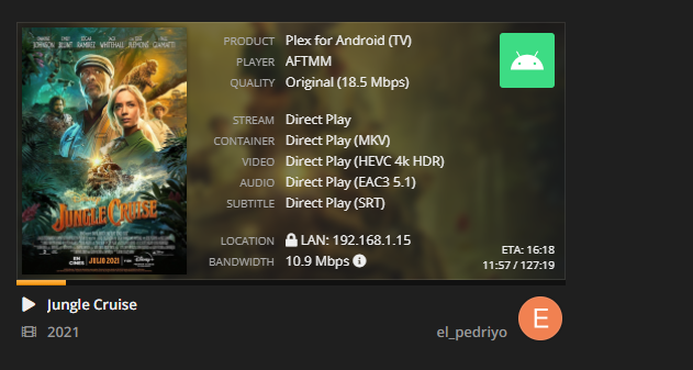

I was somehow able to “reproduce” the issue. I got a firetv to test on my local network and one from outside of it. These were the results:
From inside my network I was able to get directplay on everything:
Under bitrate 11mbps as it should be.
However from outside the network, I got this other thing:
Maxing my CPU usage when even HW transcoding is activated, and hitting 82mbps of network, which makes literally no sense. Not able to directplay on remote.

The first play was on local, and the second one on remote.
