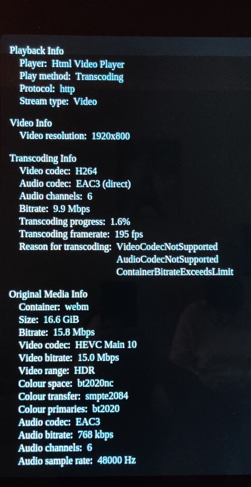

Out of curiosity I tried out jellyfin ( just to see how it would react ) and it does seem to do much better .
This image is from my phone played using jellyfin app
Is there no way to get Plex to react the same way ? As you can see from the FPS it’s using my GPU for transcoding and the subtitles are on and not being burnt in
This next image is played from the web browser on the same TV I’m using Plex on
You can see it transcodes the video down but is direct playing the audio .
So my Second question is , if I decide to transcode down to 10mbps is there a way to leave the audio untouched ? So that direct streams ? Like jellyfin is doing
In all these examples SRT subs are active.
I know Plex is very different to jellyfin but it just seems there’s an issue here that could be resolved
Plex will direct stream the audio if it’s supported. If it works with direct play, it should work with transcoding the audio too. Would need to see logs from the TV why it wants aac.
For the Shield, it only supports EAC3 for passthrough. Do you have it connected to a receiver that supports EAC3?
