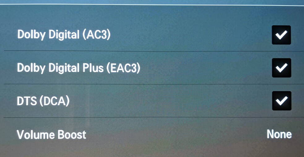

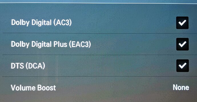

FYI, here’s the settings on my LG B7 & Plex app.
