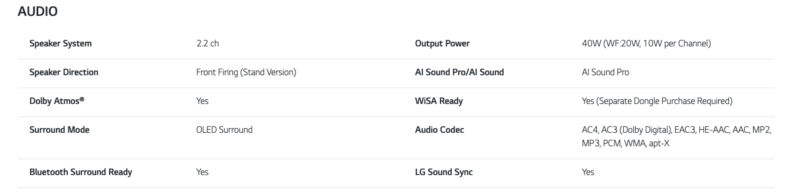

The 2020 Series of OLEDs from LG (CX, GX, etc) do not support DTS. It has been removed from being a supported audio codec. You must either pass the DTS to an AVR, or transcode it to another audio codec.
You also cannot pass DTS over ARC / eARC, as passthrough on the TVs has been disabled for DTS as well.
