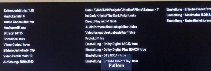

I bought a new LG OLED 77C9PLA couple weeks ago and I have problems with direct play since then. Right now I´m not able to “Direct Play” my 4K HDR ripped Blu Rays on the TV. The PMS always tries to transcode it. See:

in your second screenshot can you please scroll down to the Audio part and post that please.
The video should play without issue, my guess you have some HD-MA audio
Thanks for your answer. Here is the Audio Codec Information:
(this is the audio I choose)
I can upload the whole XML file if that is any help. The weird thing is I tried to watch the same 4k file and “Direct Play” worked today. Yesterday it didnt. Definitely nothing changed, I even made an speed check with an Laptop connected to the network port to see if I reach the full GIgabit Speed - no problem there. (copied an file from the NAS to the Laptop)

That audio should play without issue, so are subtitles used they can be troublesome
So, do you have any idea why the playback is working so unreliable even though all requirments are fulfilled? (no subtitle is activated, just video and audio)
