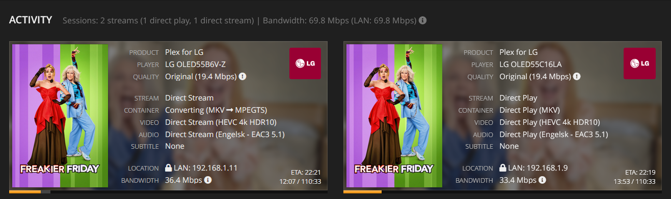

I have not been able to find any posts matching the string of errors I am getting. My LG OLED55B6V-Z TV has been able to direct play just about any .mkv file I’ve thrown at it for almost 10 years, as long as the audio codecs have been AAC/AC3/E-AC3. Now, suddenly, many movies will not Direct Play at all and some won’t even transcode if subtitles aren’t enabled. Instead they abort with an unknown error.
Bizarrely, only the .mkv container is being converted to MPEGTS while the video AND audio can be directly streamed. Just as bizarrely, this is only a problem on one of my TVs, the LG B6, while my LG C1 (next gen) has none of those problems. They run the same Plex app version (5.93.2) with the same settings on the WebOS platform (different versions) and have always both been able to direct play. It is also happening on a friend’s Samsung TV on the Tizen platform which makes me think it’s not caused by any firmware update to the B6.
I’ve tried reinstalling the Plex app as well as the Plex Media Server app (even on another PC with a new Plex account with default settings) and deleting the codecs folder to redownload the codecs. I’ve tried the playback on a GTX 1660 Super, GTX 2070, and Intel UHD Graphics 630 with different combinations of transcoder settings.
Here’s the same movie (Freakier Friday), direct playing as it should on one tv, but not the other. Quality is set to Original. The subtitles are SRT and should not be an issue even if enabled. I don’t get it.
From the log, it looks like the server initially decides to direct play but then “A critical HTML media error occurred: 4 (Codec)” as well as “Playback error occurred. Reason: Unknown, An unknown player error occurred. code: 4, message: Codec”. Then when it tries to direct stream, it gets an error code: 3 (Decode). And when it finally tries to transcode, it gives up with another error code: 3 (Decode). On some other movies, it will transcode with some audio codecs while with others, it will instead be endlessly buffering while trying to transcode. Common for them all is that it will not direct play video and audio codecs that direct play fine with other movies.
Here are some excerpts from the log for other users googling the issue in the future. I’ve attached the full log. Thank you very much for reading this and for any assistance!
