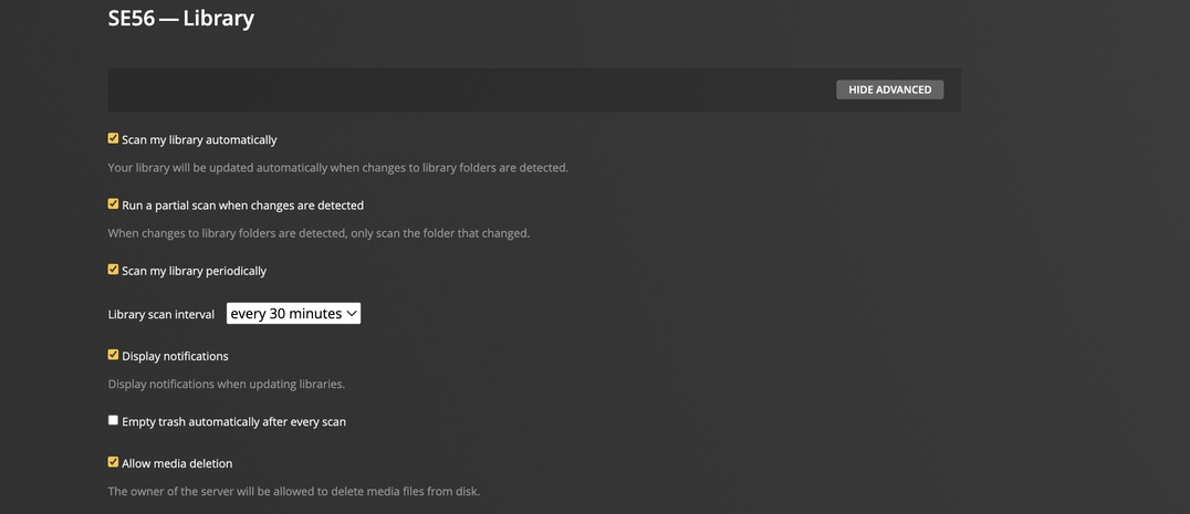

Been having the same issue so altered the Settings for scan for now.
Okay, I changed it to follow yours, but doing a manual scan doesn’t bring up any new info,
It made no difference. Manual scans don’t work either.
