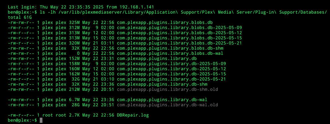

My DB had ballooned to +32GB. After the repair tool, it’s around 150MB. The repair tool took a few minutes.

My DB was sitting 42GB after running DBrepair it is now down to 579MB
