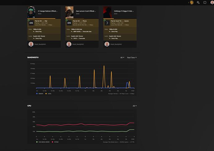

Just as an update I’ve upgraded my NAS I’ve gone for the DXP4800 Plus and running the Docker APP to enable me to run Plex Server in a Docker Container, as you can see from the above screen shot this works outstandly am I able to stream 3 streams at once, one being sent remote to my Iphone via 4G and transcoded by the built in graphics chip (HW) Transcoding works a treat and the CPU doesn’t even get in a sweat anymore so no more shuttering of my playback.
