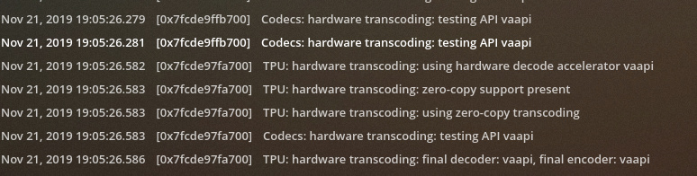

Several days later I noticed that the plex transcoder was no longer appearing in nvidia-smi. I double checked the logs and noticed that the transcoder was using the intel cpu instead of the graphics.

Is plex ignoring transcoding through nvidia because the iGPU is present?
You would ideally want transcoding done on the gpu rather than with the intel iGPU right?
Is this a design choice or a bug?
