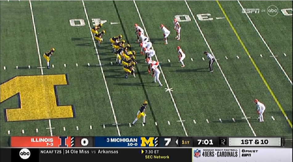

We are noticing pixelation with live tv streams with live channels. Notice the lines on the field especially:
This seems to be a recent thing and hasn’t been noticed until recent football games.
Interestingly enough it appears more apparent with still images/graphics as seen here:
Note that we have everything on “Original” so no transcoding appears to be occurring. Or maybe there is and there’s a setting that needs to be flipped somewhere? I’ve tried 20Mb/s and 4mb/s and they all seem the same.

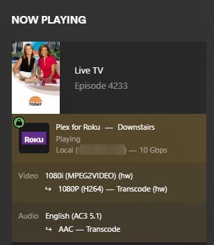

Neither of your screenshots appear to be 1080i/720p; they make it look like there is transcoding being performed. Have you checked the Dashboard while one of these channels is playing to see if a transcode is occurring? And from what to what?
All of those enabled and I’ve tried disabling them without success.
This is what I am seeing:
Thank you for any further assistance you can provide.
Looks like MPEG2VIDEO is involved even if I have that disabled? :thinking:
Yep, it always will be for ATSC 1.0 broadcasts in the US (and likely other locales), as far as I’m aware. There may be some exceptions, but they would be rare. ATSC 3.0 uses H.265 however.
That’s why I was curious about that particular setting on your Roku client. My understanding is that Roku’s MPEG2 implementation is not great (but I’ve forgotten where I hear that, so don’t quote me).

“Now Playing” is showing you that your source tuner is generating MPEG2, which for your tuner I think is what your tuner is going to generate regardless of settings in Plex. I don’t have the same tuner as you, but I don’t think your tuner has any configurations that allow it to output anything other than what the station is broadcasting. There are only a few tuners that have built in transcoding in the tuner device (for example, the HD Homerun Extend.)
Your screen shots show that hardware transcoding is happening in Plex. This means that Plex is using your computer’s hardware transcoding capabilities (e.g. not your tuner transcoding if it had that capability), and not your computer using the CPU to do software transcoding which is very CPU intensive.
The quality of your hardware transcoded stream is going to depend on the capability of your hardware’s GPU. I might be missing it, but I don’t think I see information here about what your server’s processor is and if you have a separate GPU like a NVidia card. If you don’t have a separate GPU like NVidia then your hardware transcoding is using your processor’s built in GPU. In either case the quality of your resulting stream is determined by the capability of your GPU to transcode the MPEG2 stream to h.264, which then Plex then directs to your client. Some GPUs, and many older generation GPUs, may be able to do the transcoding but may have artifacts as you are seeing.
To have a chance of Direct play/stream working you will need to have MPEG2 support enabled on your client since based on your screen shot that is what your tuner is outputting. Your client should be also set for “Original” (I think you already have), and should also be set to allow Direct Play and/or Direct Stream (this depends on the client and has changed over time, so I think all clients may not show this.)

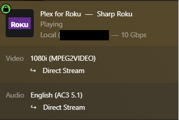

FYI, I ran a test with my tuner OTA producing 1080i MPEG2, my Plex server is a 1 Gbps wired connection, and my Roku is wired. I was able to get Direct Stream:

Hmmm, in your screen shots the “hw” in “Transcode (hw)” indicates that Plex is using something on your system to do hardware transcoding. If you have both your NVidia and also a GPU on your processor then the only way I know to tell which is being used is to look in your Plex Server Logs. I do agree that it seems like it is something with your server/GPU config if it once worked an now is sub performing.
I don’t know that you are going to be able to get Direct Play or Direct Stream with the web client for a MPEG2. It is the least capable in terms of codecs available and is more likely to force transcoding. Quite frankly I stopped using the web player for Live TV. If you want to get direct play/stream on your computer desktop the I’d suggest the Plex for Win/Mac/Linux or Plex HTPC. Both are more capable players than Plex web. The Rokus I would have expected to be able to Direct Play/Stream. I have two Rokus, one of which is at least 5 years old, and they both will direct stream 1080i MPEG2 video.
