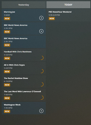

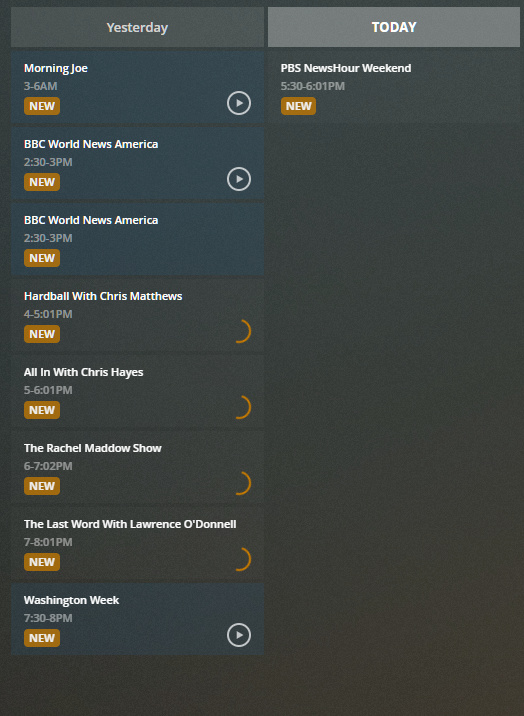

I didn’t run the batch file after the last update. Bug is still there:
As others have reported (and myself) the only way to complete this is to kill the Plex Commercial Skipper process.
