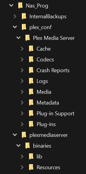

When I had my data recovered from the old PR4100, I received a drive with everything under Public and the following file structure.
$PLEX_HOME/Library/Application Support/Plex Media Server/
Do you think it’s in here under Plex Media Server?
According to Where is the Plex Media Server data directory located? | Plex Support it’s supposed to be
/mnt/HD/HD_a2/plex_conf/Plex Media Server/
This should translate to Nas_Prog/plex_conf/Plex Media Server/

Log in your NAS, go to Settings → Network → Network Services → SSH. Enable it and Configure a password.
Go to Apps → Plex Media Server and STOP it
You’re gonna ssh to your NAS with the user sshd (not admin) and your admin password.
Your Plex data should be moved to:
/mnt/HD/HD_a2/Nas_Prog/plex_conf/Plex Media Server/
Start the server again
