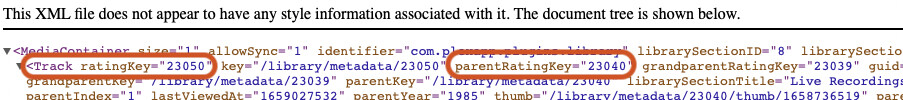

I struggled with IDs too. What I do is pick any track of an album and click the vertical …
That’s where you’ll find the Get Info that leads to View XML.
Here I’m looking at track 10 of an album, and using the elipses:
Per Track Elipses
And here is the View XML for that track. You’ll recognize the Item ID for the track circled on the left, and you’ll see the parentRatingKey which is the Album ID.
I’ll let you discover the grandparent ID :slight_smile:
