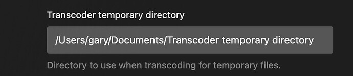

There is no need to add the transcoder Temp Directory to the Root Directory.
Just add the path to your Documents in your admin account.
Easy access if required.
Thanks, so far so good. PMS hasn’t shut down in the past hour, which is promising. I think the issue is that the entry was cleared somehow during a software update (either PMS or MacOS 13.6).
