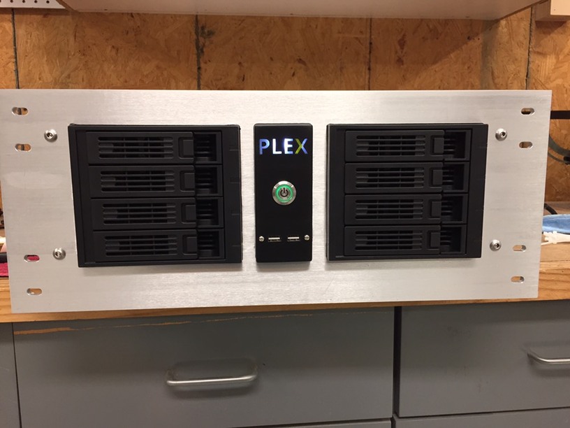

Made my own rack mounted PLEX server
I needed a small, rack mountable PLEX server with lots of room for storage. I could not find an off the shelf version the right size that I needed, so I made my own. I think it turned out pretty nice!

19” wide
16” deep

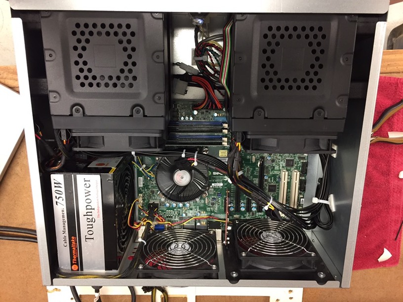

The specs are:
Motherboard: Super Micro X10SAE
Processor: Intel I7 4770S
Memory: 16 GB
OS drive: Samsung 860 EVO SATA M.2, 256GB
Power Supply: Thermaltake 750W, cable management
Hard Drive Bays: Rosewill 3 x 5.25-Inch to 4 x 3.5-Inch Hot-swap Hard Disk Drive Cage
The whole build centered around the Motherboard and processor that I had. I really liked it because it has 8 sata ports on it. I used a Sata M.2 drive with a PCI adaptor for the OS so that I could use all 8 sata ports for storage drives.
I chose the Rosewill hard drive cages because they have big 120mm fans on each one, and they were only $50. I 3d printed a fan bracket that goes in place of where brackets for the pci cards would normaly sit. This let me add an additional 120MM fan to the case. I was concerned that cooling would be an issue, but with 4 120mm fans, its not a problem now.

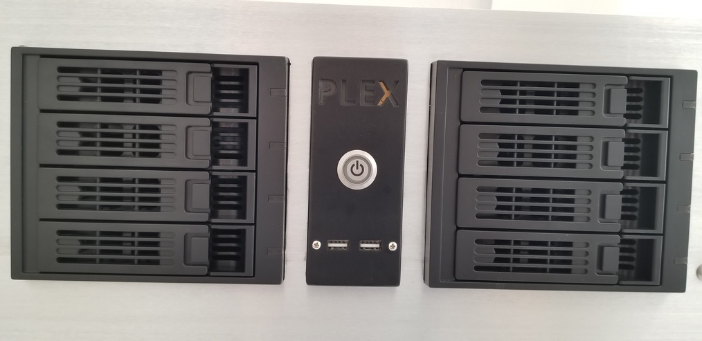

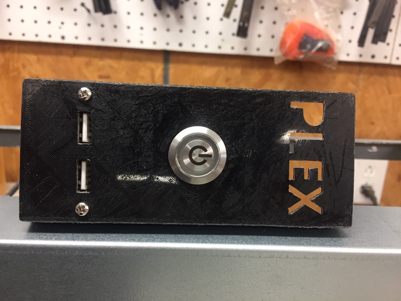

Since I had to make the case, I decided to 3d print the center panel and make it custom to plex. You might be able to see it in the pics, but the PLEX is back lit, and even has half of the X yellow/orage, like the logo.

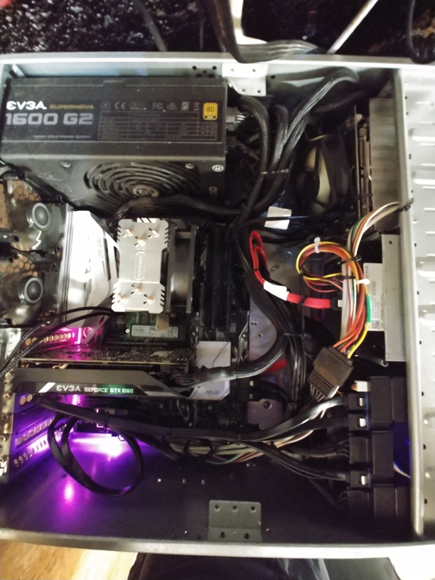

Thats the Case I used but i didn’t get it with the hot-swaps ( The same ones you’re using by the way ), i figured i would get them as time goes on, plus I already had one. I mean, I love your work but just saying that there were solutions. Heres my system in the same case.
Will eventually add the 3rd hot swap when i have the $$$$ to get more drives. Will post specs if anyone is interested. Also had my PCIe to 4 sata port card die 2 days ago, luckily, I had a mini SAS adapter card, just had to order the SAS to sata cable.
