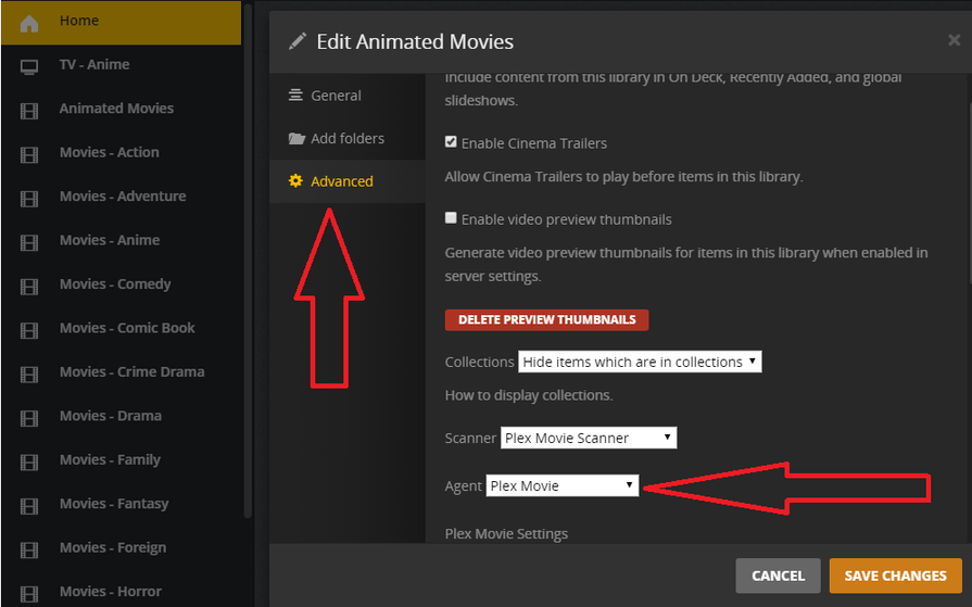

Nope, not there. Click the … menu to the right of the library itself, then manage library, edit. Go to the advanced tab, scroll down to agent.
I have no idea what you mean by that. We are talking about the web UI, yes? I’m running 1.18.1.1973, and it says it’s up to date.
I have a “PLEX” button, and a Home button under that, neither of which have a “…” menu to the right. I have a vertical ellipsis menu (⋮) when hovering over some of the items below “Home,” but that doesn’t sound like “the library itself.”
This is how you edit a library.
Then you do this.
Ok, I get it. However, if you have more things that are mismatched then correctly matched/unmatched, it might be easier to recreate your library and start over using the correct agent this time. This way, nothing will be matched and you can match them manually when needed.
Thank you. I interpreted “the library” as “everything Plex manages.” I never even considered that “Movies” was a separate library from “TV Shows,” etc., so I didn’t even try clicking on those vertical ellipses.
