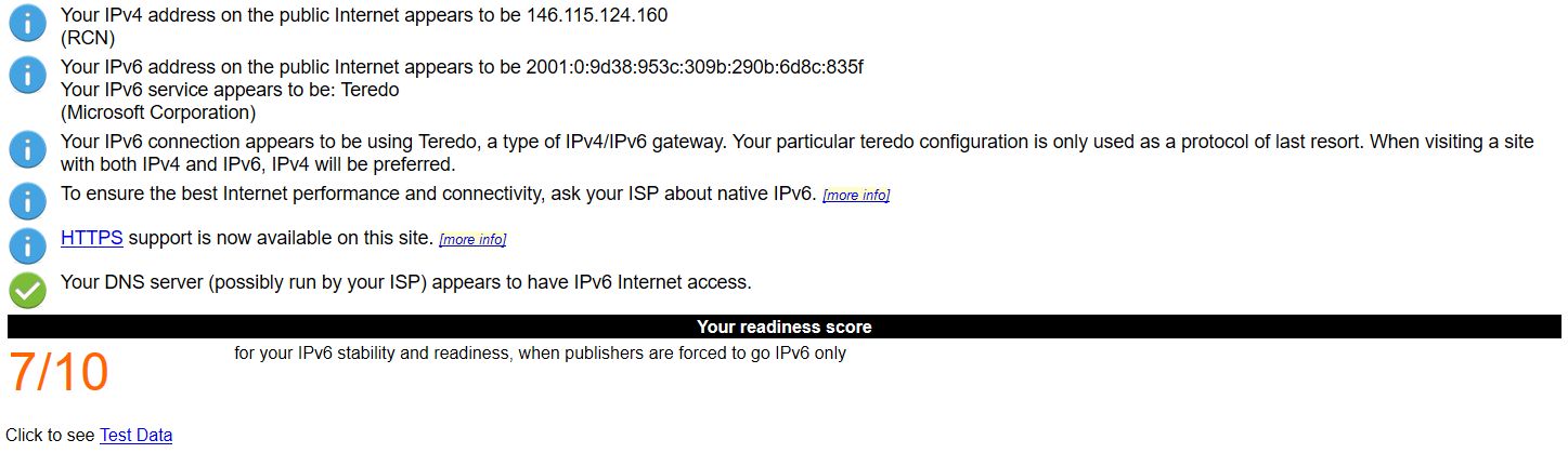

For the IPV6 ISP network survey - RCN, in the Boston area. I didn’t think they even supported IPV6 on consumer connections yet, but maybe that’s new and when I began having issues?

Now for the web test at http://test-ipv6.com:
Oh. Ooohhhh. Now that’s interesting. Apparently turning off native IPv6 support… enables tunneling instead? I think we’re getting somewhere here.
Let’s turn the IPv6 adapter support back ON and see what happens:
Yep. with native support on, it acts like it’s supposed to, and as it did on the other computer - which in the case of my ISP, means failing the tests. So the moral of this story is, Windows has Teredo tunneling built in which it uses when IPv6 support is off.
