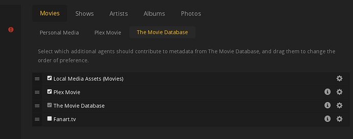

  • I’ve re-organized the Agents order 7 ways from Sunday.
  • I unchecked Local Media Assets and moved that at the bottom for TMDB and Plex.
  • I’ve changed the options in the Libraries’ Advanced settings a bunch of ways depending on the agent selected.

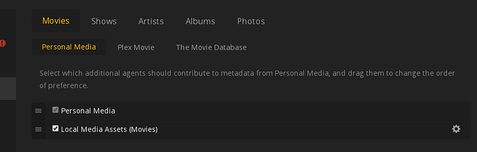

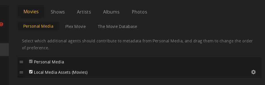

Now go to Settings - Server - Agents and mimmick mine (accounting for your plug-ins as required). (remember / screen capture yours of course before)
I don’t have any scraping issues. Let’s see what happens next. This isn’t rocket science… it’s a simple web call.
@ChuckPa
OK.
During my other attempts, I re-ordered the agents and last few attempts had the local media assets unchecked and only the primary agent for each other selected and moved to the top.
I added the local media assets back now and order like you have shown (with only one exception… for the TMDB agent, I do not have Plex enabled).
