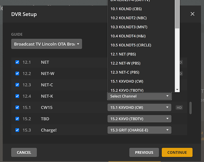

Channel number/Name: 12.4/NET-K
The NET-K (PBS Kids) channel 12.4 is missing from the EPG for Lincoln, Nebraska OTA Broadcast TV. The schedule is available below and I’ve also attempted to attach a screenshot showing that it is missing.
Thank you for reporting this. I will refer it to our provider to ensure the channel is added

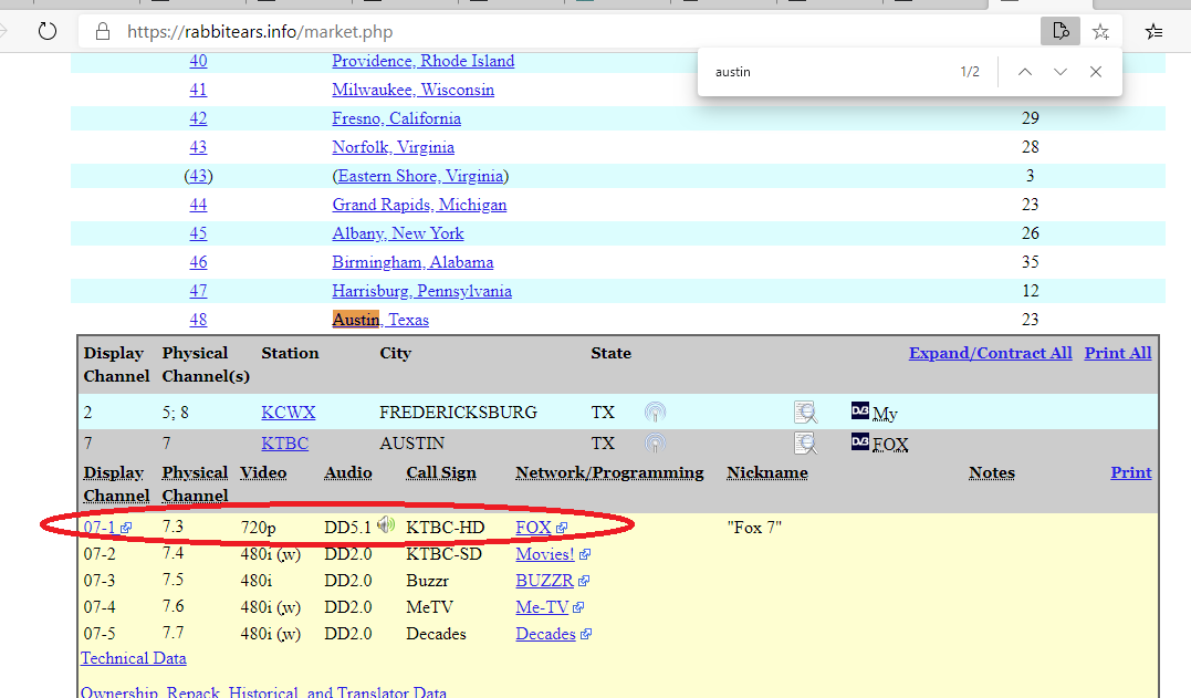

I have the same problem as above. I am in Austin Texas my ABC channel is 7.1, But I get channel 25.1 which is ABC in Waco and this is a better channel. But I cannot add 25.1 because it is not showing in the pull down channel guide like above.
Well 7.1 is already in use for Austin OTA market and is assigned to KTBC affiliate FOX. See RabbitEars.Info entries for Austin, Texas
If this is wrong and 7.x channels should not be KTBC in Austin, please let me know
There are 3 OTA lineups for Austin and they all have Fox on 7.1 (KTBC)
We cannot request another channel on the same vcn as that would cause issues for users when auto-matching channels,
12.4 NET-K (PBS Kids 24/7) has been to the lineup and there is EPG data available. Apologies for not letting you know earlier

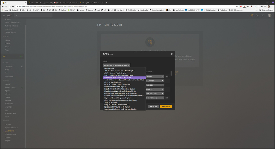

Thank you for such quick response. I am at zip 78681 (actually Round Rock, North of Austin). I am not familiar with choosing the different guides?
Looks like your on to something. DVR—Broadcast TV Austin OTA Broadcast is at the top of my configuration menu.
Delete the DVR
Wait few seconds
Setup DVR
Wait for it to auto select a lineup/guide
Change it in the drop-down to Broadcast TV Austin/Surround OTA Broadcast
and try to do setup with that
Any issues - try the other Broadcast TV Austin Metro OTA Broadcast
and see which is best
You only have one choice for your zip code
So to experiment - try out zip code 73301 and if you find one that is good - let me know and i will ask for it to be added to your zip code
OK everthing went as planned till the new selection. I only show Broadcast TV Austin
I am on Version 1.19.4.2935
Lets experiment with zip code 73301
Perfect. Working with 25.1. Thanks very much.
