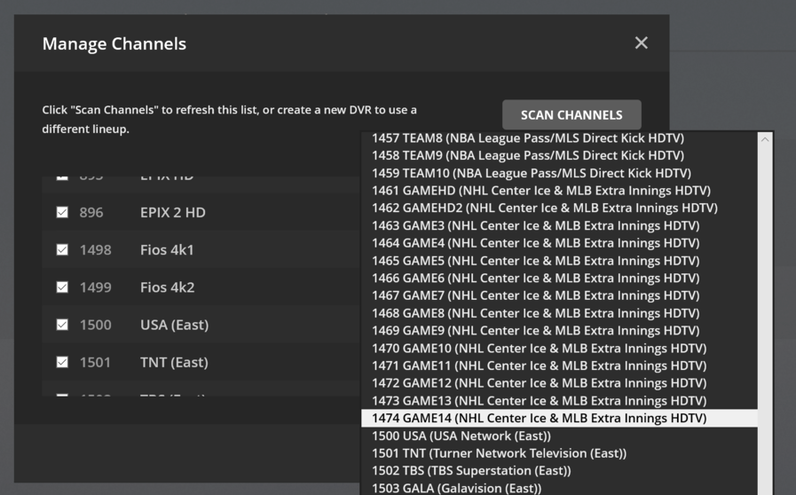

I live in Maryland using the Verizon FiOS Washington Metro Digital guide data, it is missing channels 1498 and 1499 when I am trying to map during set up. I am very disappointed as these are 4k channels playing soccer right now and I am missing out. Can you please get these channels added to the guide data? Or allow me the ability to surf channels, ie: tune into channels without using the guide?

I see you submitted a form for missing channels 1498 and 1499. This is being progressed with our guide provider

I am sorry i do not have an update yet. But this morning a change went live that would address issues with not having the right regional channels by allowing the selection of a National level lineup and for the user to manually map the relevant regional channels from the drop down.
It may not be relevant to your issue but see if there is a national lineup to test
The two channels I submitted for are still missing in the guide. It’s kind of frustrating because other providers that are free have the channels. I paid for a plex pass because I thought it would be an easy solution for TV but I find myself having to spend a lot of time troubleshooting and having to set other services for guide data. Not sure what I’m paying for at this point.
I can now see 1498 and 1499 on your lineup - could you go through DVR setup to confirm
