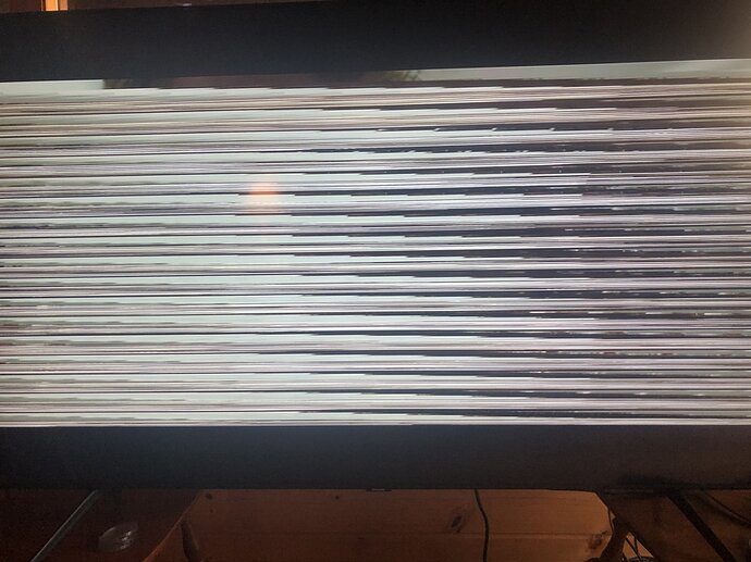

    D. Roku will play sound but picture is skewed and can’t tell anything about the scene.

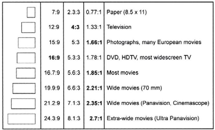

Regarding 2160 vs 1600, leave it at 1600. The difference is the black bars at the top & bottom. If you set Handbrake to 2160, it will add the black bars to the video frame. This is not necessary. It increases the size of the file and also the bitrate of the video stream, just to send all black info.
If you leave it at 1600, then Handbrake only encodes the movie. The TV recognizes what is happening and displays the video correctly.
You’ll see the same thing with HD movies. They’ll be 1920 x 800.
It has to do with the aspect ratio of the original video. Most movies are shot at 1.85:1, which is wider than 16:9 (1.78:1). When you display a 1:85:1 movie on a 1.78:1 screen, you end up with bars on the top & bottom.
Think of it this way: Draw a 1.78:1 rectangle on a piece of paper. Now, inside that rectangle, draw a 1:85:1 rectangle with the same width. The 1:85 box will be narrower than the 1:78 box. That’s why you see the bars on top/bottom of the picture.
The movie I’ve attempted to handbrake is ultra hd 4k. So it should work, but the video looks like a 1970’s tv where you have to adjust the horizontal bars
Hopefully the picture shows
The movie plays fine on Samsung plex app but not on Roku plex app
