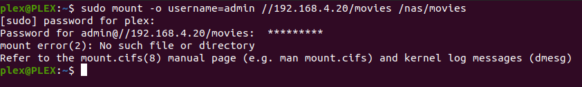

Hi Chuck, OK so I tried to use Ubuntu 20.04 Server but after a few days I simply had to give in and install the 20.04 Desktop. I’ve got it running, and I even made sure that it’s reserved IP is in the same group as the nas. I still can’t mount though, I get “mount error(2): No such file or directory”.
Perhaps I can get a job as a professional beta tester! It truly seems that I have innate natural talent
Show me what you have please.
As for “server” versus “desktop”; Desktop all the way. It takes a very proficient hand to user the server package because they do not include most of the default software found in Desktop.
I honestly think that it’s my nas. It’s weird that I can see & map it from Windows, but Linux won’t touch it. Quick question, what & why do you do these: sudo sh & sudo bash?
I can ping the nas, and at least it’s asking for both passwords:
From Windows, I can simply type \\192.168.4.20\movies and see the files
I installed smb4K, but it can’t see the nas either.
F-me! Google strikes again
mount -t cifs -o user=admin,vers=1.0 //192.168.4.20/movies /nas/movies
Prompted for admin password and BAM!

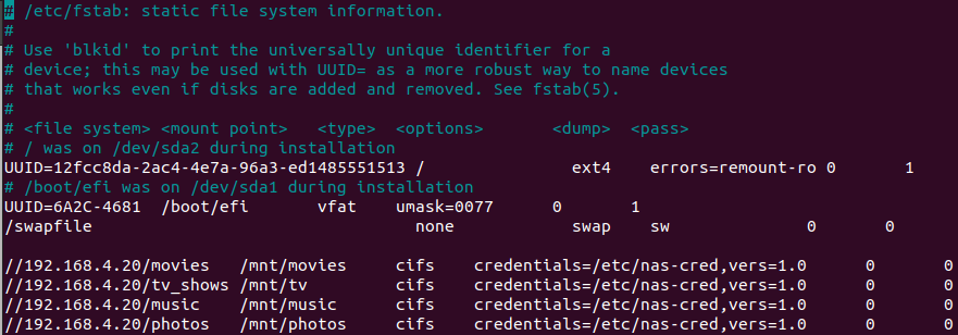

Now, just need to make automatic with fstab
All shares are being auto-mounted and accessible from the file manager. BUT, when I go to add the libraries in Plex, I can’t see the /nas directory in the browse window, and although I typed them in and saved them (/nas/movies), it’s not seeing the files. I’ve got to go to bed for now, will hit it again tomorrow.
Thanks for your help - I’m SOOOOOO Close!
You might have forgotten a step . (easily done too)
  1. Unmount the shares
  2. Check the permissions for each directory in the mount path (/nas/movies, etc)
  3. Each directory, when unmounted needs 755
  4. Now mount the shares
  5. Check the permissions again. Still 755 ?
  6. When you go into Plex and attempt to add that share, can it see the movies or is it being blocked by the CIFS/NFS server?
Do be VERY careful of the automounter (Nautilus). If they are being placed under /media (or /run/media ) then this will never work.
You must mount them away from where Nautilus wants. it mounts them with exclusive access to your username. plex is blocked. — which it looks likes you have.
