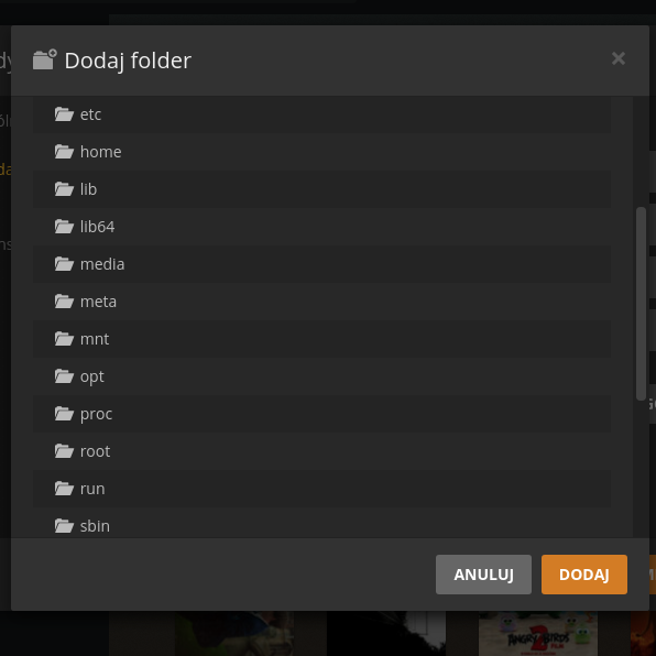

But there is another problem -> Plex app doesn’t see that location when I try to add it to Library.

Done. And it’s work. Just my Plex server doesn’t see the folder. But when I type destination manually (not chose from popup window) it’s working fine.

Done. Still I can’t see my shared folder but it’s ok.

If you can’t read it but can type directly, it usually means the r (read) permission is missing in a parent directory.

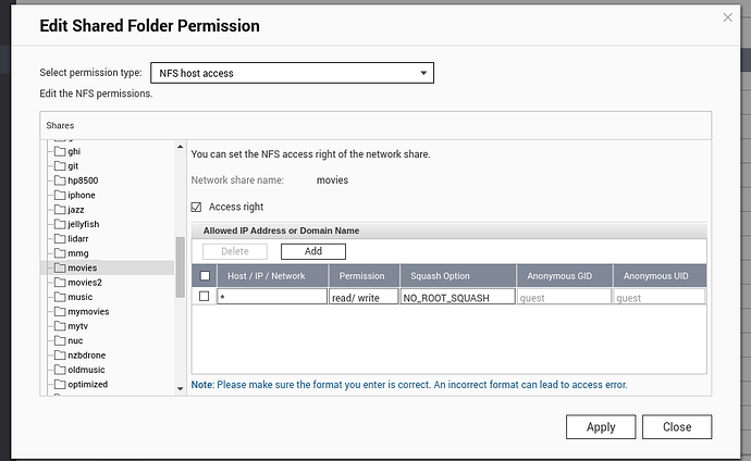

see the middle button on the right? “Shared Folder Permissions”
click it.
Now select NFS permissions in the top dropdown.
Enable access
Ok done! and It’s working like that:

  3. At plex still can’t see directory at library editing (add folder to library) you can see here:

I think I’m stupied. Plex can’t see that localization and I don’t know how to change it. Here is list of permision to that folder.
nuc@NUC:~$ ls -la /nas
total 32
drwxrwxrwx  5 root root 4096 lut 13 21:34 .
drwxr-xr-x 25 root root 4096 lut  8 23:25 ..
drwxrwx---  2 root root 4096 lut  9 22:15 Bajki
drwxrwx---  3 root root 4096 lut 14 23:54 Filmy
drwxrwx--- 19 root root 4096 lut 15 09:28 Seriale
If I right understand it’s 755 - so plex should see it. But it isn’t. Any idea?
This fixes the file permissions. Right now you have them so only root:root can access them.
sudo find /nas -type d -exec chmod 755 {} \;
sudo find /nas -type f -exec chmod 644 {} \;
NFS will provide the files and directories to your PMS system without interpretation or distortion. The host will provider any localization interpretation to PMS.
