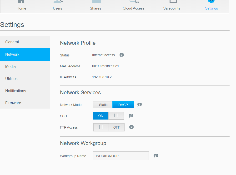

yeah I did some searches and found this:
I have the single bay:
NFS is not supported on single-bay My Cloud (firmware 04.xx.xx-xxx
)Current Version WDMyCloud v04.05.00-342 : Core F/W!(upload://v2C7r4W9XZLymaVQEbcxbqNLtiZ.png)
I modified my response but from the GUI there is no option for NFS - where later documentation says there should be one.
If you read on, it seems it can be enabled via SSH directly (which makes perfect sense on Linux)
