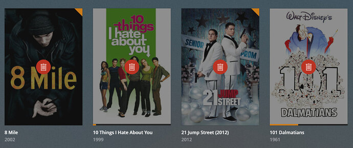

I have moved my Plex Server from Windows Server 2016 to Ubuntu Server 18.04. However, all of my media is showing the trash can icon. I transferred my config from the Windows Server and it appears to have worked as it shows all of my existing libraries. I edited the library folder location and added the “new” location of the files. It appears to scan the library for a second but stops pretty quickly and the trash icon does not go away. Please advise.

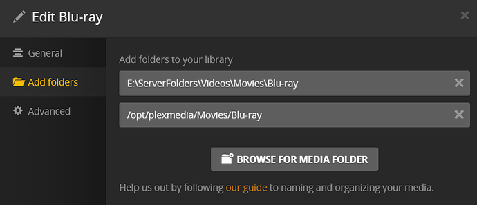

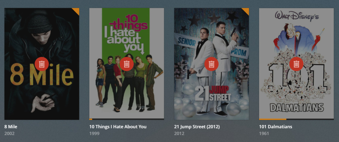

I don’t think it has to do with the naming convention as it never had any issues when it was on the Windows Server. The media is now stored in /opt/plexmedia. I looked at quite a few documents and posts for migrating from Windows to Linux and followed them closely. It was my understanding that after all the configuration/settings files were transferred, Plex would no longer see the original location from Windows. Then you edit the library and add the new location (/opt/plexmedia/folder) and it would scan the “new” location and there will be two items listed. Empty the trash and remove the old location. Instead, the libraries look like this:
that shows me PMS cannot verify the file still exists.

If you had /movies/movie (year)/movie (year).ext and then removed /movies entirely, PMS will think the whole tree is unavailable (as if removable media) and indicate what you see also. Have you made such a major change by removing the top most level?
Okay. The file does not exist as it used to. Here is a screenshot of the old path and the new one where the media files now reside.
