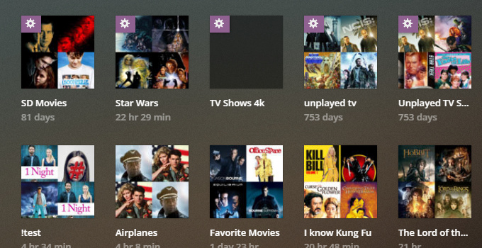

Can you screenshot your Playlists page showing the playlists you want to add to?

The little gear icon in the purple box indicates that this is a smart playlist.
I only have the one playlist in their now, but it’s a manually created playlist. Essentially, if I want to create a specific playlist I’ve had to click on multiple movies that fit a criteria (e.g. ‘Movies about Music’) and then I can manually create a playlist that includes those movies that I’ve selected. But once that playlist is created, I haven’t been able to add any additional movies to it.

Okay, that’s a standard playlist, so yeah, I don’t know why it wouldn’t be in the list.

I think it’s a smart playlist, they just have the mouse pointer over it…
Is that gear icon still in the upper-left of the playlist poster, when not moused-over?
i just tested a new manual video playlist and it works for me
and you can see here, the playlists with the purple gear are AUTO playlists and cannot have videos added (they are generated automatically)
Yeah, the gear icon is still showing in the upper left. Is there a different way to create a manual playlist other than just clicking multiple movies and clicking the ‘add to playlist’ link in the kebab menu?
good to know. feeling like a noob here, but where do you just create a manual playlist?
gear playlists are generated from FILTERS.
if you want to create a manual playlist, you must add the video from something other than a filter.

Looks like it’s apparently a smart playlist, just trying to figure out how to create a basic manual playlist now.

Okay, so it looks like I had inadvertently created a smart playlist through one of the filter kebab menus. When I went into the specific movie and created a playlist from that menu, it now shows up in the playlist menu as something that can be added to.
