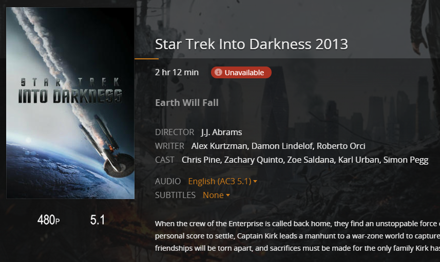

Hi everybody.
I have one movie that will not analyze and has the incorrect resolution and soundtrack listed.
This movie (like all the others) is a BluRay, burned with a Bueray player by Make MKV. I have all the info files and what have you so, update (I assume) is working. I have my setting to update the files every time I start up.
I double checked things and did find a typo in the .mkv file path. This has been corrected.
Is there a work around for this?

I suspect might be a broken drive causing this, is this the only file it is on? the fact that is says unavailable also leads to that, also can you upload logs from your plex server?
Deleted all metadata (except .mkv), updated, analyzed with same results
“fingerprint” did not work or bring up metadata.
I attached a debug log.

@MattNA1966 said:
I started another thread on this issue and it looks like I got a bad Blu-ray. It only has a Video-ts folder regular DVD resolution at 480. Not the required BDMV folder for Blu-ray.
https://forums.plex.tv/discussion/226083/did-i-get-ripped-off#latest
Kudos to OttoKerner for show’n me the way!
