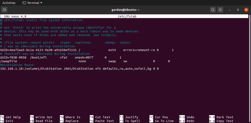

I’m having issues with creating /NAS/DiskStation. Says directory doesn’t exist. Also not sure what to enter in fstab file for nfs. Everything I’ve tried so far doesn’t work.
Got directory created, but it doesn’t like leaving out the // in the ip address of the nas in fstab. I get mount.cifs: bad UNC when I try and mount.

The /etc/fstab:
Now match the share name (again case sensitive)
ip.addr.of.syno:/Movies  /diskstation/movies   nfs    defaults,rw,auto,nofail,bg 0 0

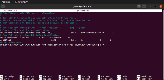

got the contents to show via ls. Not seeing it mounted on the sidebar though. Will this automount on startup?

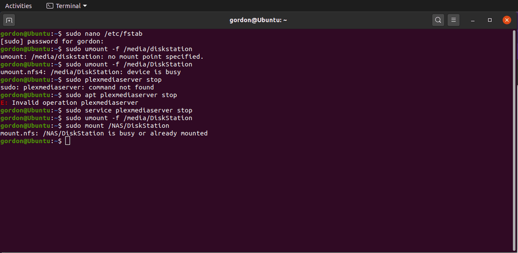

Old mount point is automounting. Not sure what to do?
If I may?
This is linux. Get used to doing things from the command line.
  1. Close everything which is using that directory. Stop Plex too.
  2. From the command line:
sudo umount -f /media/diskstation
If it complains it’s still in use - reboot (the easiest way to regain control plus your /etc/fstab will not fail system startup)
Linux is strict on permissions and which users can perform which operations. This is a difficult concept for most who try using Linux.
Ok, that’s unmounted but what now? How do I get the new mount point mounted?
sudo umount -f /NAS/DiskStation
to unmount the partition
if it refuses to cooperate, restart
Also, if you have a terminal window open with the current directory sitting on /NAS/DiskStation, that will hang it up as well.
