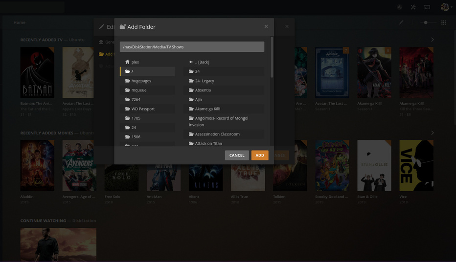

I’ve moved the mount point to /nas/DiskStation but the directory is still disappearing in plex
Did you also apply the instructions on how to mount the drive so Plex can see it?
You say the drive disappears… do you mean Plex can see its content and looses it then again?
Plex is seeing the drive. Not sure why it keeps disappearing though.
So you add it by clicking on Browse for Media Folder, picking a folder and clicking Add. Plex is showing it on the screen you’ve just shared – and later it’s gone or later it’s no longer accessible?
The folder disappears, the content remains but when new media is added to the nas, if the folder has disappeared new content isn’t detected. The media still plays though. Is the issue that it’s mounted in the / folder where only root owns the folders?

Everything still plays which is what I don’t understand.

You state /nas/movies /nas/tv shows etc? Would having just /nas/Diskstation and all folders in there mess things up? I’ve tried everything you’ve said. I’m using nfs.
