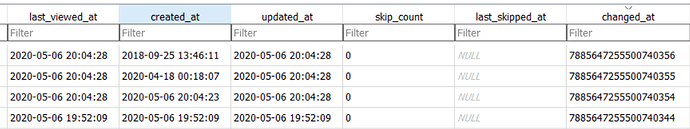

After importing the server throw a lot of “ERROR - Soci Exception handled: Cannot convert data to std::tm.” errors.
Looking at the data it seems like the change_at field is different on the old and the newly setup one.
One the old its epoch time, but one the new one its way too high for epoch.
OLD:
NEW:

The “invalid” large integers are automatically generated in new database. It looks like an auto increasing integer and not a date field, they are all sequential. The old are “correctly” set to epoch. Importing the epoch ones gave the initial errors. So I updated them all and just set them to one of the large integers. It works okayish. Watched status is set, but no on deck are shown, no errors are shown in the log. Starting one of the previous changed to the same large integer; correctly puts it on deck and makes a new auto increased number. It looks like the underlaying principal for the field is changed in some later versions. I’ll try a new fresh install for testing tomorrow to see what that puts in this field.

Looks like they changed the fundamentals on this field.
I was told this column doesn’t store an epoch timedate but an increasing integer value.
