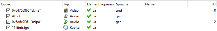

In MKVToolNix they are also recognized correctly:
