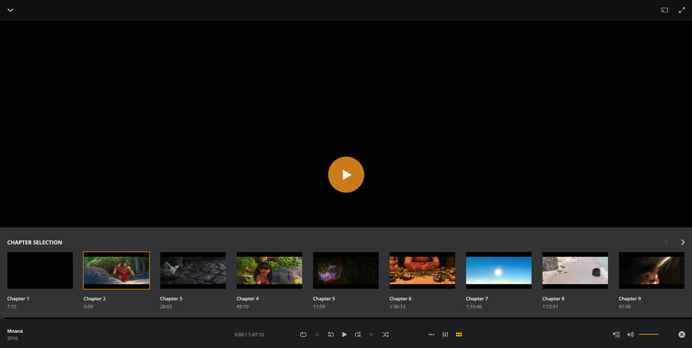

I have an issue with all of my MKV files ripped using MakeMKV from BlueRay discs.
The movie plays fine from start to finish but when I bring up the chapter menu, the chapters are in the correct order, but the times listed on the chapters are all incorrect timestamps.
Here is a photo of the web browser app:
You can see Chapter 1, Chapter 2, Chapter 3, etc. but the times listed under the chapter names are all out of order. This makes the chapter functionality useless. The same issue occurs on the Nvidia Shield app, but on that app the chapters have their actual names instead of just Chapter 1, 2, 3, etc.
I opened the MKV file with VLC and the chapters seek at their proper timestamps. I also opened in PowerDVD and the chapters have their correct times as shown here:
Why is Plex not able to read the chapters properly?

Here is the XML for the list of chapters. Hopefully this gives you some good insight.

That is so weird.
I wonder if it’s has to do with those chapter titles in double quotes.
Could you please post the rest of the XML as well?
Below is the full code. I did not add those chapter titles. Does the Plex Movie agent or The Movie Database download those chapter titles? I do notice that some movies have these titles and some do not. I think the movies without the titles are correct.
That double quote does look suspicious because it may think it is closed out before it really is. But even without the double quotes if I compare my Start Time of the first chapter to yours, they are different. It appears the Start and End times of my chapters are different than yours. For example my Chapter 2 start time is incorrectly ā€œ0ā€ and your Chapter 1 start time is ā€œ0ā€ which is correct.

This Happened after the update ā€œ1.13.4.5251ā€ … so i had to revert back to the older version " 1.13.2.5154"… Chapter Thumbnails assigned to wrong Chapters (After Update 1.13.4.5251) , Shield TV chapter title and timestamp don’t match
Didn’t went into details as above but i guess this is what i faced when i posted but in my case timings were correct just the thumbnails were assigned randomly to different chapters… (when i checked on Nvidia Shield )
Thank you. These issue has been occurring for several months and was not specific to a single release. Also, it affects all clients that support chapters, not just the Nvidia Shield because the XML output of the chapter list has the incorrect start/end times. I have just updated to 1.13.7.5369 and the issue still exists.
Could you please extract the chapters from your file with MKVtoolnixGUI
(save as XML)
and post them here as well?
When did you add this movie into your Plex library?
If it was already several weeks ago, could you perform the full Plex Dance with the movie and re-check afterwards?
Hello,
Below is the XML of chapter output from MKVtollnixGUI. This movie was added on 4/11/2017. I’m on the beta update channel and I check for updates every other day so whatever version at that time was available was most likely the server version.
I added Top Gun on 8/9/2018 and the chapter times are also out of order.
I added Ready Player One on 7/27/2018 and the chapter times are also out of order.

Hm, these are in order, just like they’re supposed to.
So I assume it has to do with the chapter titles from ChapterDB, which Plex fetches to augment the existing chapters.
After performing The Plex Dance on the Moana.mkv file the chaters are correct. Below is the xml output
One thing that is different are the chapters names are not there anymore, so where did these chapters names originally come from on the previous XML output?

See one post above.
Please include the content of the tag chaptersource which appears earlier in the XML to confirm.
Got it. The original XML had chapterSource=ā€œmixedā€.
I’d like to try and reproduce the issue. How is plex obtaining these chapter names from ChapterDB? I checked the agents and do not see an agent by that name. I also cannot get the names to appear after refreshing the metadata of the movie.
ChapterDB queries are integrated into the Plex Movie agent.
You could try and delete the
https://support.plex.tv/articles/202967376-clearing-plugin-channel-agent-http-caches/
Before performing the Plex Dance with an affected movie again.
Thank you. I deleted everything in the cache folder. Restarted server, performed plex dance. Chapter titles are still not appearing.
I’m assuming that when the movie was originally added it downloaded this list of chapters from here: http://chapterdb.org/browse/209167 How do I force the metadata to download the names?
