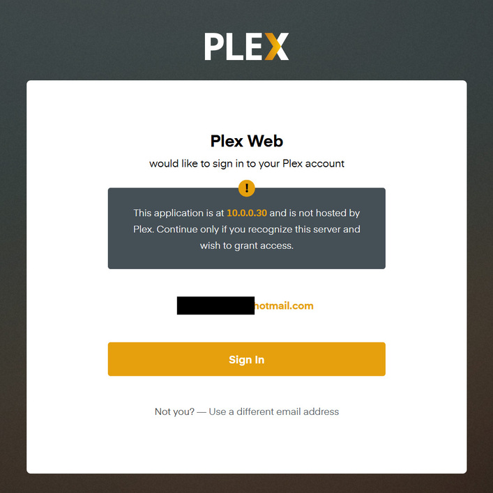

Msg: This application is at and is not hosted by Plex. Continue only if you recognize this server and wish to grant access
I’m getting this message when I try to signin to Plex can someone tell me what this means?

Its my own Plex Server and as you can see, the message is so large that the Button (orange) will be hidden :expressionless:
I am still confused by this message (see attached).
I am running the Plex Browser App. Is this the application that the message is referring to? Who is hosting the Plex web page (app.plex.tv)?
Also, I don’t see any server identified here.
Thanks for your assistance.
We’re looking into this currently. It’s absolutely confusing and this isn’t the intended user experience.
Our authorization service (the logic behind the /auth/ part of the URL) will be updated to avoid this confusion.

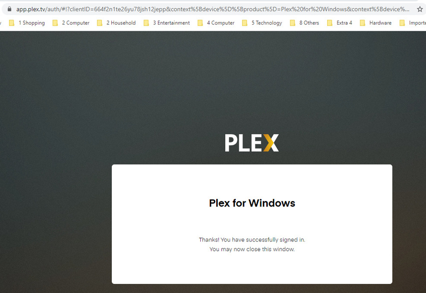

But, I now have another plex.tv logon issue. Where do you close this window ? …

The browser window itself. In this case it appears to be the only tab, so you close the whole browser.
