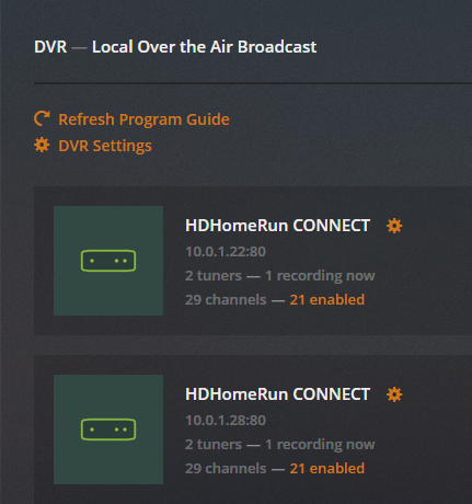

I just had a show error tonight myself. On investigation I see that Plex tried to record to one of my HDHR Connects:
Aug 09, 2017 23:30:00.528 [6552] DEBUG - DVR:Segmenter: Creating a new recorder for http://10.0.1.28:5004/auto/v57.1
Problem is both tuners for that device are currently recording 2 other shows.
Plex thinks it is recording one show on each HDHR Connect:
The other HDHR Connect is not being used at all:
So Plex must have a bug in the logic assigning tuners as it does not really know what tuners it is using for recordings apparently.
Plex does receive and error from tuner device that recording failed:
Aug 09, 2017 23:30:00.675 [10836] ERROR - [Transcoder] http://10.0.1.28:5004/auto/v57.1: Server returned 5XX Server Error reply
