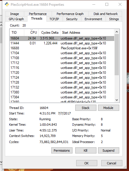

Multiple instances of PlexScriptHost.exe ! 100% CPU !
As said, after I leave PMS running for a while , it generates 4 Phyton.exe that use up to 100% cpu.
I’ve seen that multiple people seem to have the same issue and I’ve tried their fixes.
While using Process Explorer this is what I got so far:
The said dll has 2 states:
One in which it as 7 lines and always ends up in some Pyhton dll
And other that appears after I refresh a couple times, which is way longer
From what I’ve looked up, this ntdll.dll can be related to drivers/corrupted runtimes.
Still I’m not sure what to next.
PS: I did toggle library scan options and I’ve not reinstalled Plex Media Server yet.

find the process for the com.plexapp.system
If you can find the command line used to launch the process that would identify the bundle - system.bundle
